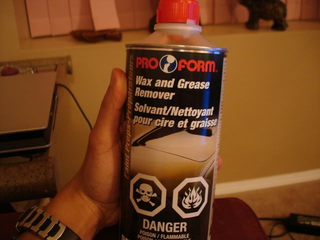

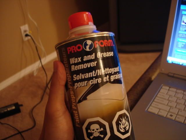

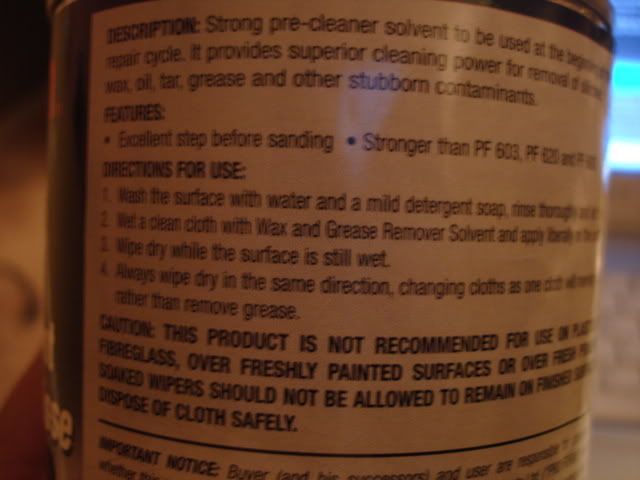

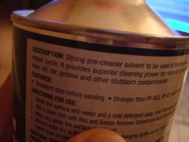

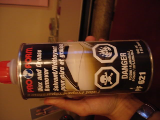

    Okay I got the product right infront of me the name of the product is Pro Form Wax and Grase Remover.
    Here are some pictures:
    [​IMG]
    [​IMG]
    [​IMG]
    [​IMG]
    [​IMG]
    Sorry for the blury pictures but at least you'll be able to get a few information from the pictures.
    So my friend uses this for just about everything in his shop.

    why do you have that carlos? I understand wanthing everything but body shop poducts? are you planning on taking marco polos advice?

    Prepsol is always good for removing tar, bugs, random things that you get on your paint. I don't see why you wouldn't want to have some in your collection. :D I am thinking about that 5 gallon bucket of body solvent....seems like a good deal.

    Well when I told my friend that I was using a 50/50 alcohol wipe down after I polished he recommended that I stop using the 50/50 alcohol mix and use this product instead. He said that on some vehicles a 50/50 alcohol wipe down is not a good idea. I've used this product once or twice and if you ask me it does the same thing as the alcohol wipe down perhaps a bit safer :confused: but again I was following my friends suggestion..he knows more about this then me...as for the oils on the clear coat...that he had mix feelings about. This is what my friend said...oils don't penetrate through the clear coat, oils are basically on the surface of the clear coat but never go through to the paint it's self...so what you said about car shows I agree with you.
