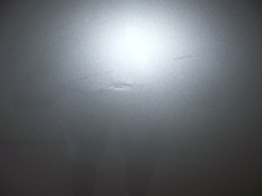

    Here's a couple posts of mine from another board
    Another (huge gouge)
    Before:
    [​IMG]
    Filled
    [​IMG]
    Surfaced:
    [​IMG]
    To be honest Phil this is something that does not yeild PERFECT results... I tell people "if you cannot notice it from 4-5 feet away the job is a success"..... You have all the tools to fill, wet sand, compund, polish I would really suggest that route
